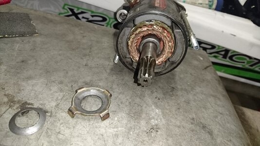

I went with 24-cell AG to be sure I would have plenty of juice.
This is what it does to oem and generic starters within a month, armature tries to go through front cover, bends washers, which in turn short out the windings
12 volts is still 12 Volts... Shouldn't matter how many cells you have. If your pushing more than 12 volts, then I cans see why you have the damage you have

You can't "push" amperage through anything. It's dependent on the over all condition of the device... A perfect starter might only draw a few Amps regardless of the total ampacity of the battery. Now a starter with bad bearing or high compression will draw more (warm cables after long cranking) and a locked starter will draw the max ampacity of the battery which will end up in a fire somewhere in the circuit. Now it's possible to feed something too much voltage and it will take it, for awhile, and then you'll get what happened in the picture above
If it's trying to push through the front cover that hard, then my thinking somehow your stater is turning into a solenoid with the way it wants to push out. I also wonder how it can push that far out and still stay connected to the brushes. If voltages do go up during cranking, I'd think that's a defect in the battery

Multiple starters destroyed, oem and generic, so can't be starter's fault. The bent front washer shorts the armature before the pickups can come out of the brushes

If it has to be the battery, our best summation is that the low internal resistance of the lithium battery, combined with the large CCA allows much more current to flow than a conventional setup. The starter doesn't draw more than it should, just more than it would from a stock setup. It may not even be for long enough to record on a meter but rather just the initial inrush of current when the starter is first energized. The extra kick is slamming the washers and moving it a little bit with each start until it's finally bent enough to cause a short.
