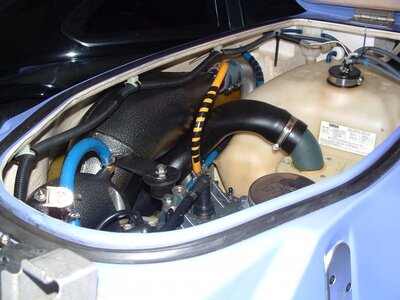

Looking to hear from experience on Blaster mod chamber setups with porting and dual 44's, don't need speculation but helpfull info from someone who has tried this combo and their feedback/helpfull tips.

I got another tank if needed I can heat mold to clear, just trying to find the perfect setup for an LPW ported motor with dual 44's and 185psi......its just a sick looking setup mocked up in the hull.

You will need to dent about 1/4" deep, though not actually making a 1/4 deep hole, but making a flat section about 4" in length at the elbow just past the head pipe. That is manditory, however melting your gas tank is all that is needed to clear the cone. Then get a stock blaster exhaust hose and that will work for your exh tubing.
As for that motor, it sounds like that chamber will give you a bigger and faster hit than a limited chamber will, but you should check with some guys who are going to do port work on it.

Hell no, building a sick replacment T motor with Pauls 61x 83mm freeride porting with big carbs for the RN, slowly collecting pieces for the build. Already dented along the side, fits nice.

i have the blaster mod chamber in my sn right now gone back to the factory pipe so i didnt have a limited chamber its being used in a famous ski right now , you might have heard of it mason waddle superjet lol, so i had a spare mod blaster chamber and it fits good a little dent sorry fox i am good with hammers i used the lord mount that installs on the flywheel cover, some of the guys at daytona had your setup and they like it, i am using hydralic hose to install from chamber to waterbox what hose are you going to use

Post up some pictures for me, not sure yet on what hose I will use it goes from 2" to 2.5 at the waterbox end. I will have to make some major mods at the liner to the WDK hood and relocate the air tubes for sure........

i will post some, one of the boys at daytona was using a nice marine exhasut hose that was flexiable and it looked great but i could not find any in canada, goggle marine exhaust hose there are places in the states that sell it and is not to expensive and becasue of the angles with this chamber the flexiable hose makes the installtion nice and easy h2odesperado had it on his ski at daytona

I have used that chamber in my ski before, years ago. The stock, uncut exhaust hose works perfectly.

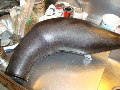

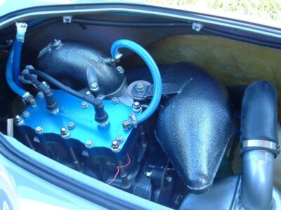

Someone say Mod Pipe?
Mod on one, Limited on the other. The other one? No pics of.,but there is a Mod Pipe sitting right next to me. ;)
