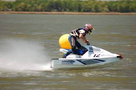

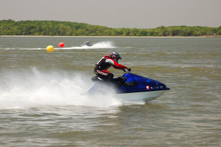

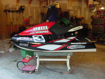

Here is our fleet
Joe's is the black and red blaster (TJ Built lamey PV)
My two are the white blasters with blue/grey and red/black trim (both lameys-Tj Built PV)
Jason's is the solid blue (Full Spectrum dominator big bore)
The Euro is Joe's (Full TJ SS twin pipe'r)
And last but not least, the "Duece" (a full SS 1200 powered Blaster 2)
Scott

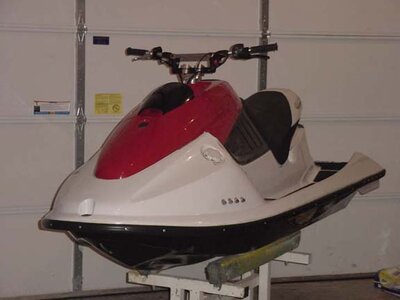

what is a eruo? is it because its blue i cant tell what it is?
they made the blaster800 (gp800 pv motor) for a few years in the late 90's. It was only available in Europe... I hear they are not that great of a ski. (for freeride)

Hi my bros got the Blaster 800, its not a bad ski but is alot bigger and heavier to ride than a B1. Shame it wasnt released in the US cause you cant get anything for them, pipes etc:frown:
