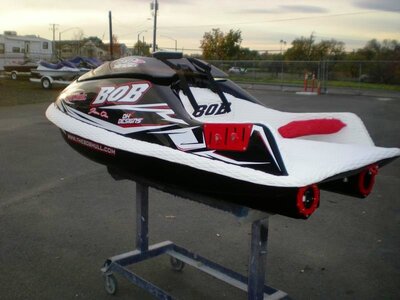

The hull : a brand new Gen 3 BOB , Kevlar layup , black on black with white and red graphics and white turf with red foot pods. I got both the long and the short ride plates

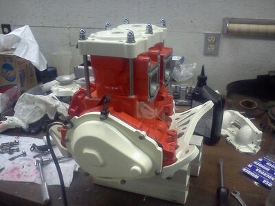

the motor: Patch motors 701 on its first bore , all brand new , pat rebuilt the crank and reassembled the motor bottom to top, ADA girdled head and new boyesen reeds

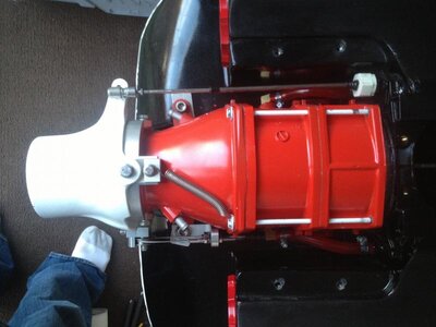

pump: stock SJ stator and wear ring , wamiltons exit nozzle and compleate trim system , solas concord 11/17 impeller , stubby pump cone

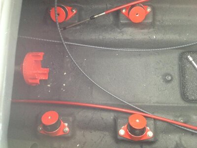

stock SJ motor mounts
stock SJ mid shaft housing and couplers
Stock SJ steering cable
motion pro throttle cable

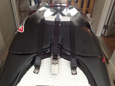

Ski clinic hood straps and ratchet strap
