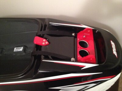

Yeah ... I didn't like the way the hood shut with the hood latch so I figured the best way to check it was with a light inside in the dark ... It's pretty easy to see what seals and what doesn't that way ...
You can't adjust your hood hooks so the front stays down tight when you do up the latch? I just installed the hood on my Footrocket and it is definitely not going to be letting any water in.
The bobs only have one plate in the middle of the front of the hood ons it's not adjustable ..
Ahhh, ok I didn't know that. That seems pretty silly that it's not adjustable, especially since it won't even hold your hood closed snug.
I don't think this is a wide spread issue with bob hull ... I have a very light lay up and that prob has something to do with it ... DK at the ski clinic was great when I found the issue... He shipped my hood back to Cali to see what was going on at his cost ... Put it on a few different hulls with a few different ways to attach the hood and even sent me video of each way to show me what was going on... He gave me a couple of options and I chose the ratchet strap wich he sent me with my hood ... As of now I don't have any light that shines through my seal ... Untill I get it on the water that's all I can go buy... The 2 gen 2s we have sitting here weren't sealing in the back buy the latch and not nearly as bad as mine was.. Every one of these hulls are hand laid and by definition going to be each different... I would recommend anyone with any brand hull do the light test to just be safe....
