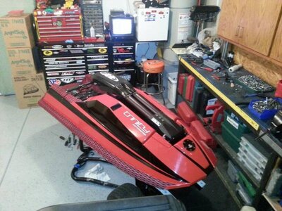

It's more of a reassembly than a build but I figured I'd give it it's own thread. I do have some paint change plans for the distant future but for now I just want to build it and ride it.
I wasn't planning on ever parting with my ES hull but I showed the 'Pro" sale thread to my wife and she convinced me that for the right price, it was a no brainer. I made an offer and 1900 miles, 6 states and 32 hours of driving later, it was in my garage.

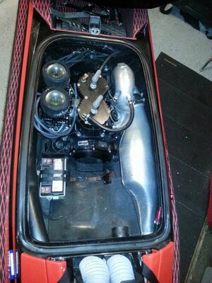

Engine and electrics;
X-Scream SS846 Billet cylinder kit (annodized black) (195 psi)
OEM Trued and Welded crank
64U Cases ported and epoxied by X-Scream
Boyesen/Full Spectrum Extreme Velocity Intake
Dual Mikuni 46's modded by X-Scream and painted black
B-Pipe modded by X-Scream, (limited chamber) and ceramic coated by airborne Coatings in Denver, NC
Prok Filters with Outwears
JSS 62T Stator with JSS Stainless Laser cut washers
JSS Coil
JSS Battery and Starter Leads
TBM Lightweight Charging Flywheel
Cold Fusion Billet Flywheel cover
Billet UMI lightweight couplers
ATP E.P.I.C. programmable ignition Module
Deka ETX-9 AGM battery
Custom aluminum mini Battery box
GP800 Motor Mounts with Kenney Keepers

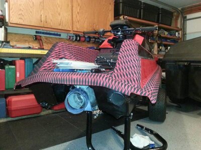

Well I want to strip the decals, turf, footholds and paint off it but Scott is telling me to get it on the water for this weekend and worry about all that down the road. The decals are coming off regardless and I don't imagine the turf and footholds will last more than a week or two. The paint can wait however as I hate the whole concept of sanding and painting.
I guess I better toss some reg letters on there as well.

I like the red and black paint, just not the turf. Red is a nice accent but there's a point where it becomes too dominant.

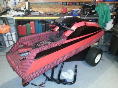

Nice looking ski for sure. How do these hulls carve pretty good ?
They carve very well as they have excellent traction. Makes them almost too stable though and it takes a bit of learning to get them to slide out. Once you master rider input though it's the best of both worlds and is a good solid all around ski.

As far as the paint goes, looks like it is the offspring of the original and Sott's ski. I'd kill the decals and ride it for the summer.:bananalama:
