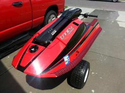

Finshed up today and will put it on the water tomorrow.
I have to admit, the colors are growing on me....still not digging the turf though.

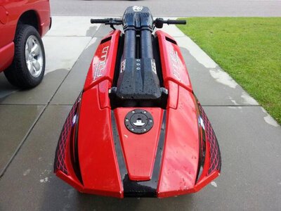

Boyer you missed a couple different angles there! :)
But the ski looks great.The previous owner looks like he took good care with it

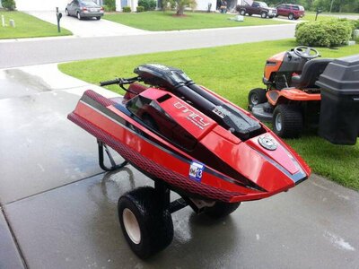

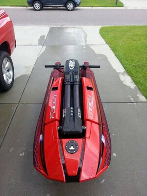

What can I say, I'm thorough. Pics are for posterity, in case it ever goes missing.
Actually I took them for SCDNR and figured I'd post them. I started filling out all the paperwork necessary to get it titled and registered properly. Hopefully it goes as smooth as my last hull. Going to cost me $340 in application fees and a few phone calls I'm sure. I stickered it up with my old reg numbers in the interim.
Previous owner barely rode this thing so it's in pretty decent shape. Lots of little chips and scratches though.

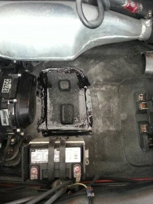

Previous owner ran a power factor pipe and smaller gas tank so he removed the tank strap mount and bumper to keep the tank in position. I had a new one made up so I ground out the old one and epoxied the new one in this morning.
Not having the main tank strap is one of the reasons I wasn't keen to head south quite yet. I knew she'd be passed around the group like a cheap whore so I didn't want her to get inverted until I had everything secured properly.
Have I ever mentioned how much I hate working with composites?

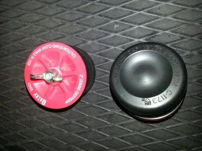

This is how I fixed my Thrust Scuppers. Guaranteed to never leak again.
The opening into the engine bay was an odd size. 2" plug was too small and 3" was too big so I had to make something in the middle. I started with a standard 2" mechanical test plug, upgraded the bolt and wing nut to stainless and then slipped a 1-1/2" rubber cap over the works to create a 2-1/2" drain plug for under $8 each.
This way I can pull them out quickly should I ever feel the need to scuttle the boat or test it's buoyancy.
