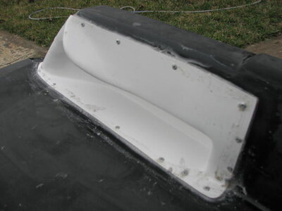

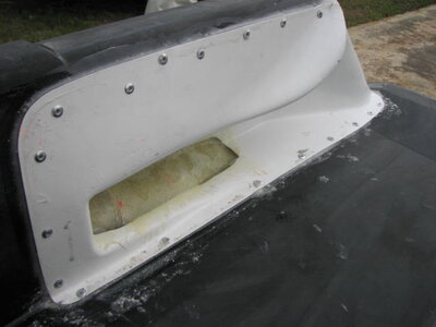

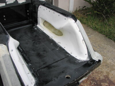

Lots as happened since I last posted!
Here is my ski as of today. We installed Blowsion Klowners. I had to cut the exhaust side footwell down to better fit over the exhaust pipe. Thanks Beachjunkey for the help.
Next up is lots of grinding.
Scott

Thanks Bronson-It was good seeing ya last weekend. Bummed your ski wasn't working. Getting the holds in was easier than I thought it would be. I'll be tearing it up with ya'll soon enough. Hopefully tomorrow I'll get part of the basic grinding done.
