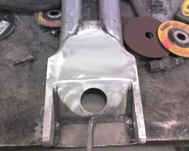

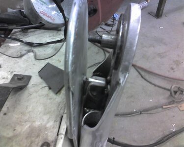

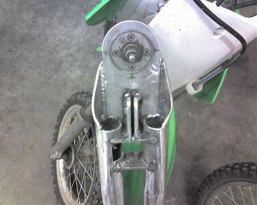

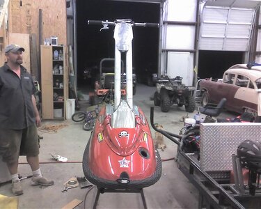

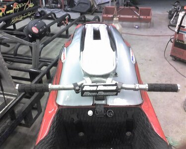

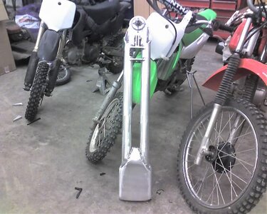

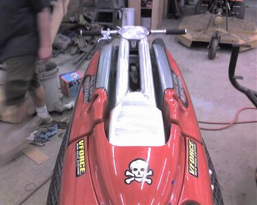

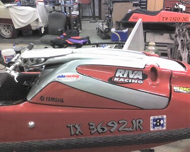

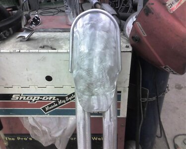

Well, we rapped it up about 1:00am this morning, all thats left now is some minor touch up with some filler and paint. Total weigh in 14lbs, pole/bracket/chin pad. Total stock 10lbs, pole/bracket/chin pad. I guess we can live with four extra pounds hell, Yamahammer could skip Pizza Hut just one night a week and save that. Anyway, we ended up with about 12hrs in the whole build and kept the parts under $150 :arms:

We tapped all the holes into the 1/2 inch aluminum for a clean look and kept the chin pad small and compact for more of a slammer look. The steering cable mounts inside one of the 2 inch pipes (that was fun) and the whole thing comes on and off very easily. All in all we are very satisfied with how it came out, shouldn't have to ever replace this pole, maybe the hull, but not the pole.

Awsome job... looks killer! The weight sounds comparable to a X-metal pole+ bracket.... that thing looks freggin unbreakable!
I would Pay $500 for that pole no question!
So do you want to make anymore? lol
Were going to give this one a test, see how it holds up. Then I'll have to sit down and put a pencil to it and see what kind of pricing would be fair to both parties. Thanks for all the props :01:
