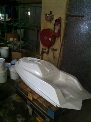

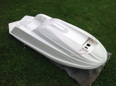

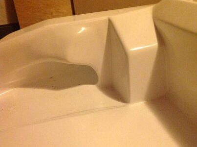

Soo received my hull from maxx yesterday, and besidde from some scratch on bottom of engine Bay, from the pump it lookes realy good. Shipping took about 30 days buy boat from Bangkok too Denmark, have been in contact with a Danish shipping agent along the way. And besidde from some custom problems everything has been trouble free. Its going too bee a winther build soo dont need too rush things. Hull came with hull/svupper/hood/155 mm pump shoe (160 also avilabel)/ worx 242 intake grate/ 155 mm pump (160 availabel)/ 2 inch setback shaft/ cone/bearings and seals.
Rest of setup Will look something like this
Dasa 1000 10 mm (cast cylinder)
ADA Big bore gridel head
Riva dual 48 mm carbs
PHP intake
PFP exhaust
ATP flame
155 mm maxx pump
Titan pole
ATP steering and bars

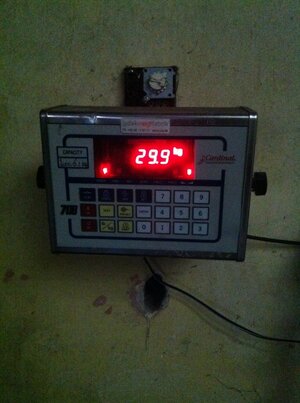

Thats really light for a glass hull. Price is right too..

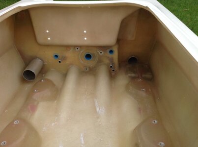

The intake track for the pump is bizarre and interesting, but I know that's the BUN design so I guess it works.

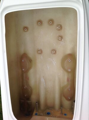

Only thing I don't understand is that notch in the bulkhead on the left side? I'm sure there is a good reason for it as well, but I can't figure out why its there.

Battery and exhaust clearance, looks like the engine is pretty close to the bulkhead/front of the tray. The finish on the inside of the hull looks really nice, I like where the steering cable exits the bulkhead, not sure why a lot of hull builders put them in such a stupid spot basically pointing right at the rear motor mount.

That looks surprisingly good. Good for you. Ride report asap and let us know how everything lines up when building it.
Yes it is light i was a bit concernde about that, but it has less flex on the side off the hull than a stock superjet.
Intake lookes tricked out i think superfreak has it too ???

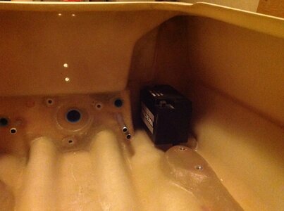

This is the first hull I have seen with the extra intake tract like that. Freaks don't have them for sure. Neat idea.
