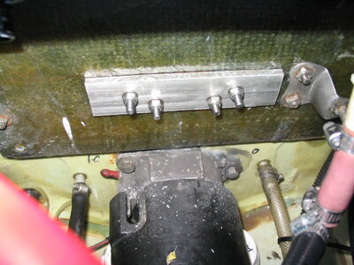

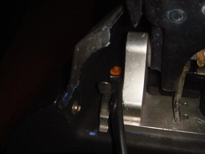

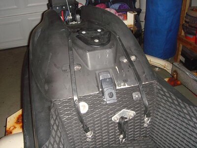

Just set up mine a few weeks ago. So far so good. Haven't landed any big rolls on my side though so time will tell. Bolted the front of the straps to the front hood bracket bolts. Just replaced the existing with a longer bolt. As you can see I couldn't find a stainless bolt long enough so this is temporary until I do. For the back I bolted some stainless u bolts to the same bolts that hold the electrical box on through the bulkhead. I didn't even drill any hole for this set up. 2 bungees-Home Depot, 2 stainless 1-1/4 u bolts- a boat shop, and some stainless hardware-ace hardware, total cost about $10 bucks.

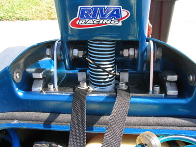

My setup doesnt use bungee cords but I do have it set up with battery straps and nylon strap. It works out really well.
