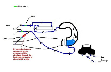

No, the 4mm restrictor is the pisser comming off the T. The t-fitting is the achual bypass
Since I am using 3/8 pissers then I am going to have to use actual inline restrictors.
After reading tons of thread and using Arts recommendations I have come up with what I think would be a good starting point. What do you all think?

I've read that whole thread a couple of times, but most of those recommendations are based on one line going to the headpipe and one going to the manifold.

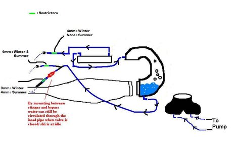

I just got off the phone with Art and he spent a great deal of time with me on the phone talking about restrictors.
This is what he recommended for my setup and the fact that I ride in 65F water in the winter and 85-90F water in the summer.

Yeah I was planning on running single cooling, but I decided to go with dual cooling just for the safety factor. I know I don't have to worry about keeping the engine cool, but I ride in some dirty water sometimes and I like that security. I plan on using the restrictor recommendation for dual cooling that Art gave me for now.
What's great about his restrictors are that each restrictor comes with multiple size restrictors so I'll be able to fine tune the cooling as water temperatures fluctuate throughout the year.
