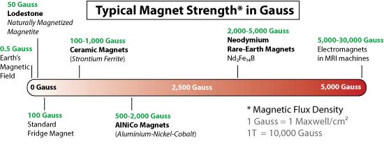

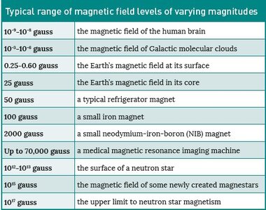

Looking at the Chart, looks like it's in the Ballpark; but how does it compare to an ACTUAL Gauss Meter reading of a Known Good Flywheel?
