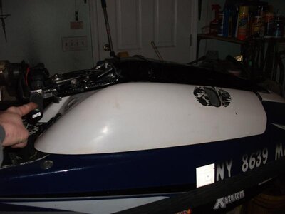

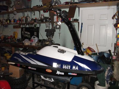

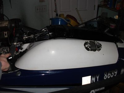

it was a -2 pole, i went 3 inches shorter. so -5 total.
nah no grinding. i don't feel like messing with it. the pole has cracks all over the place at the top and is pretty abused. im probably going to be in the market for a new pole sooner than later.
just going to turf over it and it won't be as ugly.
BruceSki
Formerly Motoman25
Long Island
here are some pics with the hood on. its short.

if you grind the welds down you lose all its strength. i cant see that pole with the welds all gound flat not snap in half.the ac pole is such a piece of crap in the 1st place.they crack when you dont cut them up lol.

im very happy with it how it is.... i don't think it's possible for me to kill it the way it is right now.
it's not a fashion show out there, although some people may think so. it's not like we are running around chasing 1 ft boat wakes here. i need it to function in big surf.
so what a little turf to cover up a booger...... id rather it be strong.
