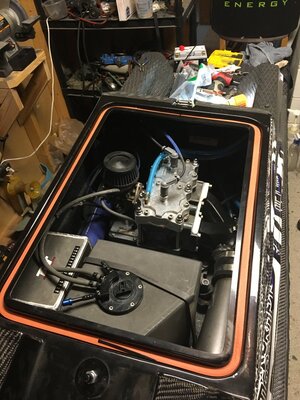

Looks good. What intake grate is that? I have a hybrid v2 on order and I'm planning on running a tpe 1105 and 155 pump. What did you do to get the 2 piece pump to fit? I was told to order a 1 piece bc the 2 piece might have clearance issued
The pump required a lot of work. Phil Clemmons sent me the pump with the grinding and fitment clearancing already done on the top. The bottom also has to be clearanced to fit under the ride plate. The intake grate is a jet dynamics that has to be clearanced to fit. This was by far the most difficult pump install I have ever done. A 144 or 148 would be a breeze. But not much room to work with that 155 crammed in there...

Did you stick with the +4mm TPE
Yes he did! This format has unbelievable potential! I can't wait to see what I can squeeze out of it!
While we did endure parts delays, I had time to really explore this motors capabilities!
Will be fun getting it to the water and start tuning!
