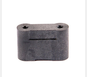

Looks like those black inserts in your tray are the plastic inserts for foot straps. One set for front and rear already setup regular foot for you like your sj
