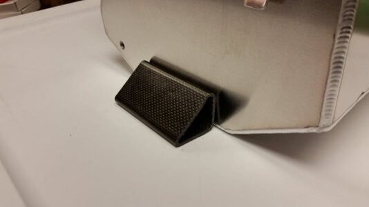

Carbon locators

I heard someone is making a cradle that the limited slip tank mounts into. That would be nice.

The limitedslip locators are nice! If you end up with them, I would drill some holes in the bottom of them, and use something like Gflex to glue them down, and make sure you prep the hull surface too!
