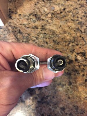

What can be causing the carbs to load up after shutting engine off. I have to hold throttle full open to start. I am trying to get this thing tuned in. One thing bad about these taper bores is that I have no one to compare to. I tried increasing pop off to 32 and it was too lean on the low end. ski wouldn't get going. I have only had this problem since winter build when I increases compressiong with ada head and changes reeds to the ones Jetworks sells for the boyensen RAD valves. Here are mods and settings:
Mods are taper bored 38 by group k, r&d arrestors, ADA head 185 compression, dual cooling, rrp pipe. Lightened flywheel by group k MSD ignition enhancer, ngk coil and wires. Fuel air separator by group k. That's it for engine mods. Oh carbon fiber reeds by Jetworks that go on boyensen RAD cages. Jetting 150hsj 90lsj 1 3/4 turn hss and 1 lss pop off 25. right now idles fine at 1 turn out on low speed screw. I hit gas and seems like it's loaded up. I have to pump the gas a little to get it cleared out. I did notice when I took reeds off three rides ago the one pedal did not seal all the way. Thanks for any help. Oh, I have read every carb tuning article out there.

I had a similar issue with my SPX last season, unable to start after shutdown. It turned out to be a leaky oring seal. Maybe not your issue, but something to consider. If the top of one of your pistons is shiny clean or there's gray sludge, it's a water leak.
