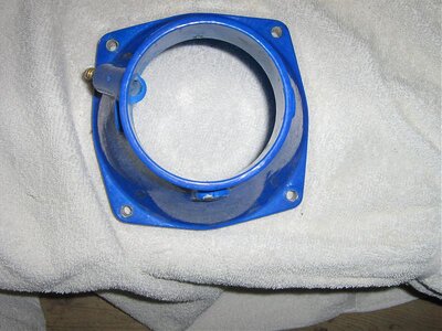

Tell Mario to be on the lookout for one of these, note they have holes for trim mounting or on an sx.

Not that ocean pro crap, (sorry Ken), those are just way over valued as well as the PJS stuff. There are however some 85mm nozzles floating around that will allow the use of trim. That blue one looked right, but it needed to be measured to make sure. An SX cable will work like a champ for the bottom pull, and use the bracket that came off an SX.:headbang:When are you going to come out west? If you need, I can bend you one up with some diamond plate (assuming I can find the scrap).

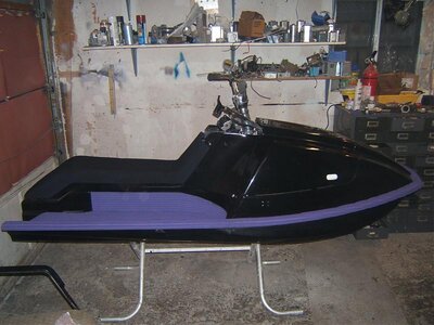

thanks crab great info that is about the last thing i have to do going to install pump tomorrow . with the ocean pro head i have 170 compression which will be ok with super gas, we painted seat with black fabric paint it looks good on the can it says that paint is waterproof i hope it is will post pictures tomorrow keep forgeting camera,its so cold today , hey justin maybe going i will have to see, its no problem for me to drive to fla done it about 25 times piece of cake.

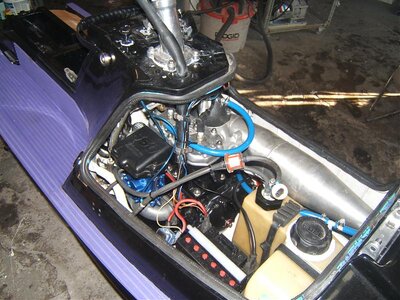

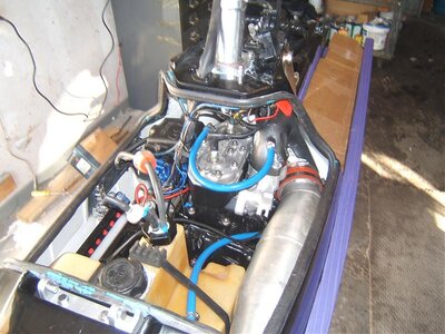

A look under the hood. This one is for you CRAB!
Everything was nicely installed, pipe, water box, fuel lines, fired up sounds great! Life is sweet.....go to install pump and find out that drive shaft that I bought off EBAY for 5.00, does not fit, its 8-10 inches too short, R U KIDDING ME...WTF! GUESS WHATS NEXT?????.........................................................................................................................................................................................45 minutes later. We reinstall old drive shaft that has some pipe wrench marks on it that bugged me So, I wanted one without any marks old in and it works! Fired her up and life is SSSSWWWWEEEEETTTTT! No stress PCOLA anyone???? HINT HINT DOG!
