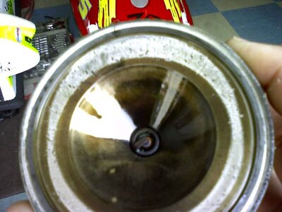

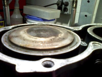

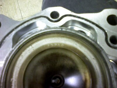

My motor never had the squish checked...The pistons actually stamped their part number up in both domes. The squish made the cylinder rattle loose, the squish spun sprak plugs out and the squish tore my brand new stuff up. If there is one thing that I feel any engine builder needs to be sure of when assembling a motor is that it doesnt leak and the squish is correct. He assured me of one and concerned me with neglecting to do the other.
Art at Jetworks has my motor and concluded that due to some light machining of the cylinder it needed a thicker base gasket. He has been extremely receptive to me and is helping me put this thing back togatehr as cheaply as possible. I really appreciate his time and speedy help.
