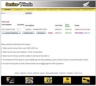

You have to first sent the part to the parts list then send it to the cart to show the discount.
jjchambers
got me my braaapp!!
Sarasota, FL
that's a great deal! I just tried it and it worked (didn't really buy it) They won't show the shipping charges until you checkout so I'm not sure how much it would be shipped from IN to FL but it couldn't be much.

Check out www.servicehonda.com $406 The do all makes not just honda...Sorry I didn't find this post earlier Shawn.
The actual price shows up after you send the part to the shopping cart. These guys have the best prices.
No worries, honestly I might order another just cuz I am a sucker for a deal...LOL Now I need a deal on new oem cases...
i still cant figure out how to make this site show the discount price...
tried it with a starter motor....its listed at 270, but again..cant get it to show the discount price
also, looks like greater yamaha uses the same server/program as this place and they both advertise 30% off OEM parts
has anyone found anything better than 30%???????

Just a FYI, you cant get the 760 crankshafts from www.servicehonda.com for $406. I placed an order online for a few crankshafts last night and I recieved a phone call today from them with the correct price (something around $640 each).
I asked them not to process my order.
