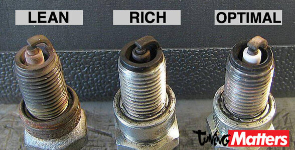

This will tell you , do a high speed full throttle run, come straight to shore and pull your plugs out
White is optimal? LOL! Who are you? Stop trolling this kid and trying to get him to waste his money and blow up his motor..
