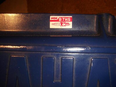

My stock motor ('04) had a factory sticker calling for b7hs. That being said I have an aftermarket head and have always run br8es.

A stock SJ does indeed call out a B7HS plug. I switched to a B8HS because I can get them in solid core when the B7 are not available. I didn't notice any difference in performance or engine heat after the switch

I have 2 2004 sj's that clearly call for B7HS with decals on the motor as well as the manual.
I only changed plugs when I changed the head. My wife's ski is still bone stock and runs B7HS.......AS it should.
What do you mean not true? read post #8 where I said stock OEM SJ's call for a B7HS and then see the pic of the sticker on the pipe in post #16 You are saying the same thing.
