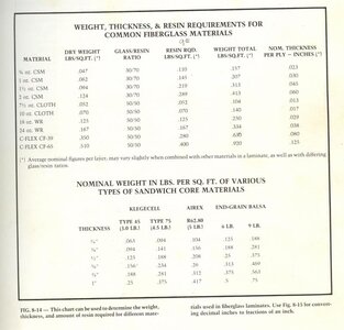

Some rough calculations.....for a 50lb. project.
50/50 resin to cloth ratio (hand laid), That means 25 pounds is resin and the other 25 pounds is cloth.
Resin weight approx 8.75 lbs/ gal ($43.00/ gal- US composites) 3 gallons= $129.00
8.3 oz carbon, 1 lb = 1.928 yards. 48.2 yards=25 lbs. @ $41.50/ yard = $2000.30
$2129.30 for basic material.
