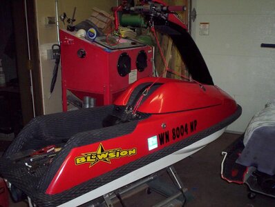

Stock carbs and reeds made the 62t come alive off idle, sucker rips now! Tubbies and D cut plate make it super loose, can't wait for surf. (My ghetto garbage bag numbers)
