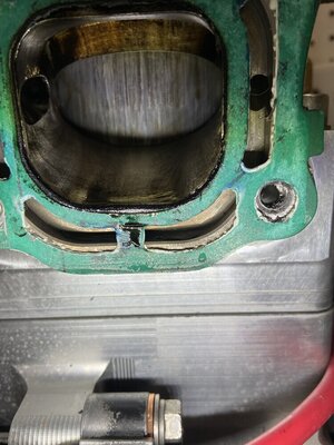

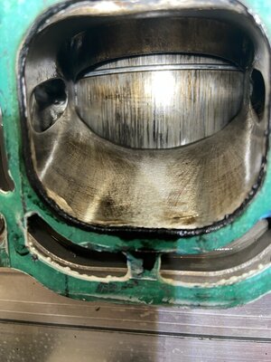

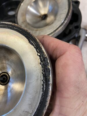

I'm working on my buddies Dasa 1200. He just got the motor last year and someone else installed and tuned it for him. He has burned up three sets of orings on his domes in a VERY little amount of run time. Probably 10 hours at the most. They look like over cooked pancakes.
It seems to get the hottest right between the two cylinders. Between heat and water ingestion I am now rebuilding an almost new motor for him. After the first set of orings burned up I warned him to not do more than a couple of revs out of the water. I thought maybe he was running it out of the water too long.

Are those Viton O-Rings? Viton has a higher/better temperature rating (437F).
Buna-N/Nitrile (250F) or EPDM (300F) probably can't take the Heat...

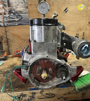

Find TDC with a dial indicator, degree wheel bolted to the crank snout, wire arm to see degree, make marks.
I run a TL so I just use the timing light on the brain w/ the degree wheel then verify with a timing light. See attached.

Are the surfaces flat? Are the domes tight in the shell? Have you tried different domes/shell combo? Both domes or just one?
I might double check the head surfaces and cylinder. I could see how that would cause the oring to leak, but not how it would cause the orings to melt.......????
