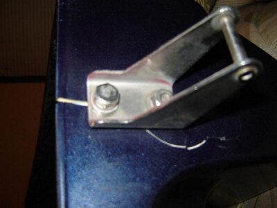

two tips on the hood mod i learned the hard way at lanier
make your handhold liner strong and use more than two layers to secure it, and reinforce your hood hook area a lot.
...that or don't let jeff marsh ride ur ski :rolleyes: see attached evidence
(its all good jeff:biggthumpup: )
Hey, Jeff is just doing a little R&D for ya :arms: :arms: :biggrin:

Marshj said:
since you didnt get to see your work, other side is cracked too but not as bad. need to port your engine, probably less work than fixing my boat after every time i let you ride it. :biggrin:
note: i had 2X3" aluminum, 1/4 thick behind that ******** too.

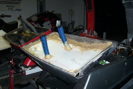

here's a pic of my handiwork....ok, so I went a little overboard on the liquid nails....but the thing is solid, you can stand on it!
oh, and there's also a pic of the blwsion liner installed on the red hood behind it...
