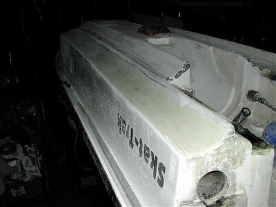

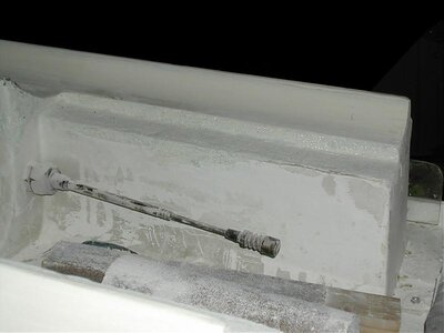

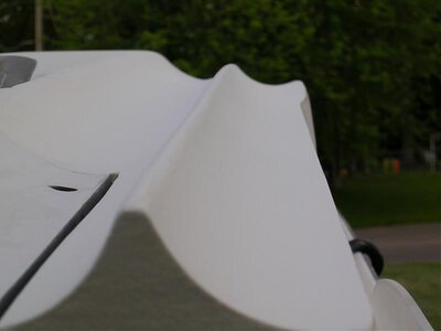

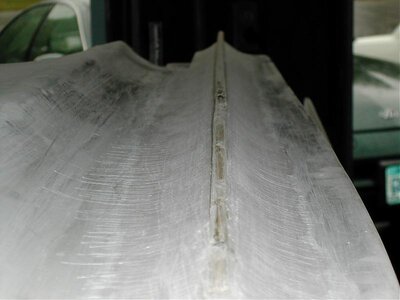

I spent a great deal of time doing this to the bottom of my Kaw-750SX.
I added a little over an inch to the bottom of the chines. Here are a few pictures of what I started with.
I knocked down the peaks of the existing chines and added some long thin strips of balsa wood to create the new profile for the chines.
Eric.

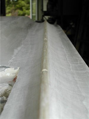

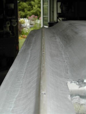

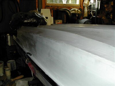

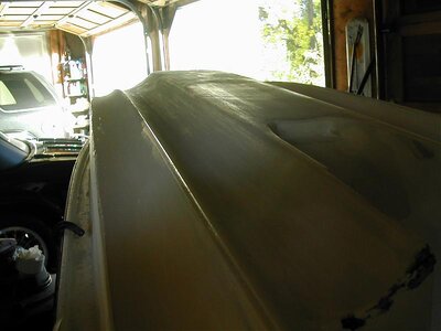

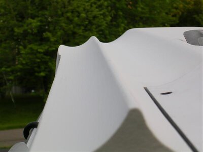

I used a thick epoxy paste with cabosil and and chopped strand fiberglass & chopped strand carbon fiber for a majority of the build up on the chines. I used a few different lengths of of 4" dia PVC tubing to form both the inside and outside radius of the chines. (I did the outsides first as you can see in these pictures).
After the epoxy paste was dry I sanded out all of the high spots with another piece of 4" dia PVC tubing with 36 grit sandpaper taped to it.
I added a few layers of light weight fiberglass cloth, draped over the chines between each application of paste during the build-up for strength.
In total I think I did about five applications of paste to get to the profile I was after.
I used a thick epoxy paste with cabosil and and chopped strand fiberglass & carbon fiber for a majority of the build up on the chines. I used a few different lengths of of 4" dia PVC tubing to form both the inside and outside radius of the chines. (I did the outsides first as you can see in these pictures).

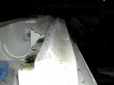

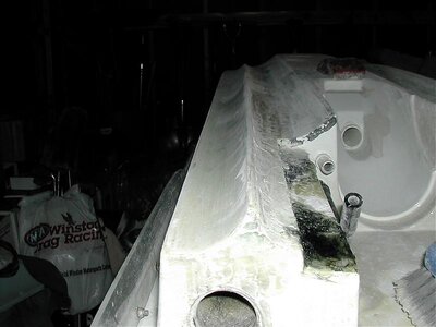

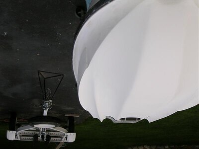

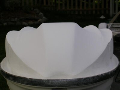

More pictures.

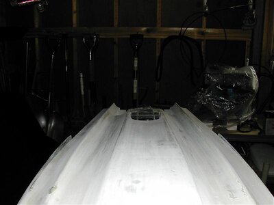

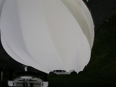

All done :smile:
