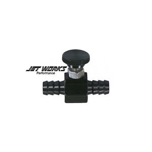

I use these to restrict/adjust engine temps. Only 8$ for two shipped on amazon.

I like the pinch idea but would be nervous about the line.....obviously its a cheaper solution...

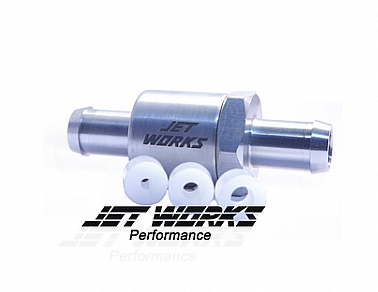

View attachment 339544 Jetworks also has these a little more pricy
