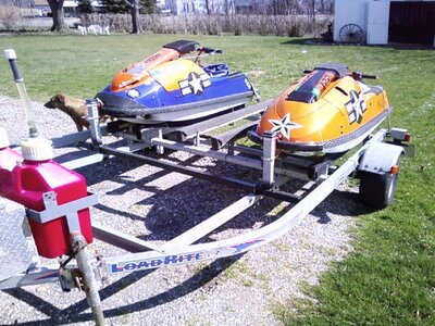

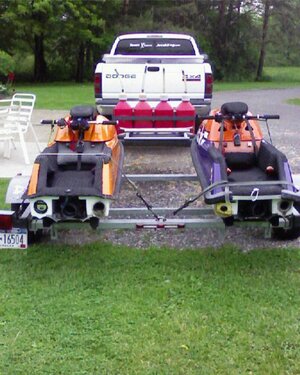

I use the narrow part of the 2x4 on mine... measure between the chines on the rear of the hull on each side of the ride plate... they're something like 12.5"s apart. that's the perfect spot...

For my X2 it is like 12 or 14 inches center of 2x4 to 2x4.
Just make them adjustable. Just drill a series of mounting holes for whatever bracket you use 1/2" apart. You WILL have to adjust them for another kind of ski at some point in time. No need to limit yourself.
