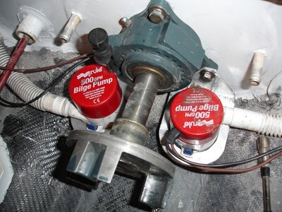

mo oem siphon, dual 500's, sometimes air lock no biggi just shut off and on again, helps when switch is mounted to bars...
cheers
