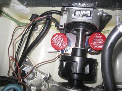

Looks perfect! Thats what I want. Can you explain the fuse situation? My single rule is just wired to the battery and to the bilge handle pole switch. Thanks!I'm in the middle of this project myself. I debated back & forth a few times whether to epoxy the pumps or use the Blowsion bracket. Ended up buying the bracket...mainly because this is my first SJ build & didn't want to screw up the placement & give myself a clearance issue later in the assembly. Other than the cost, the other negative on using the bracket is the pumps sit about 3/8" above the hull liner instead of flush, so they won't keep the ski as dry. I removed the scupper on mine because I'm using that thru-hull for my dual cooling. I know some people don't like doing that because they feel better having a mechanical backup that won't fail like an electric part. My simple fix for that concern was to wire each pump on a separate fuse. The way I look at it is, even if one pump fails, a single 500gph on a 3/4" hose is still gonna dump a lot more water than the stock scupper on a little 3/8" hose.
Here's how mine looks so far...obviously the wiring isn't done & haven't yet installed the pissers & hoses.
That is top quality there my friend. Care to give a newb an explanation of the setup you got there?

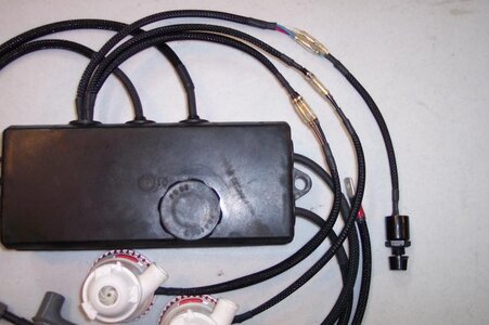

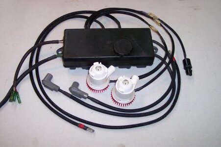

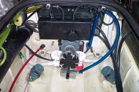

I hated having 2 sets of wires on my batteries so I designed a harness that installs into the stock electrical box. Besides cleaning up the engine bay, it also moves the main connections inside the box and out of the reach of salt and corrosion. Fitted with watertight connectors, it's plug and play so you shouldn't have to mess with your bilge for many years to come.
I offer them in several different configurations.
$45 for a single bilge, $55 for duals, you supply the pump and switch of your choice or I can supply them too.
I'm putting a fuse on each brown wire from the pumps, then splicing them to a single wire that will run forward to connect to the switch wire. The black wires will be spliced to a single wire that will ground to the bolt hole for the coupler cover. The splices will be soldered instead of using connectors, then covered with liquid wlectrical tape & finished with heat shink tubing. Should be pretty bulletproof that way. I had thought about using weatherpack connectors to connect each pump individually so one pump could quickly be swapped out without pulling out the all the wiring, but I decided against it because it just adds more stuff that could fail.Looks perfect! Thats what I want. Can you explain the fuse situation? My single rule is just wired to the battery and to the bilge handle pole switch. Thanks!
