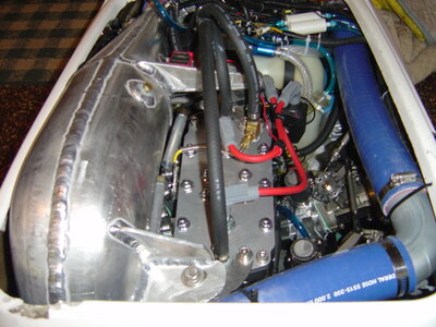

You can run dual fmf pipes too! Guy that posted the photo's says the ski runs well like this.

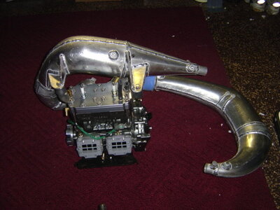

I have been there and done that. I know what your thinking and I couldn't be convinced by anyone that twins on a stand up were not ideal. I had just had to build my own. I did this about the same time the TBM's came out - winter 04'. Mine were made using some stampings that were made for the GP1200R for Rius. I also made mine dry...waterjacketed. (More work, more welding, more time, and more weight!) Lots of time, did I type lots of time? tons of time. Looking back it was something I'm glad I did. Just like painting a car...did it once, never again. The twins worked....I broke lots of parts from vibrations. I also owned at least 3 sets of TBM's. TBM's fit better and worked good. However it was hard to beat the overall performance of the FPP single pipe. Twins definitely spun higher and carried the ski to higher speeds. I tried twins with stock, limited, and stroke mod setups. All cases nothing produced the top speed of the twins...... but no twin setup matched the snap of the single pipe for racing around bouys
Twins weighed 45-47lbs dry. Mine and TBM's
