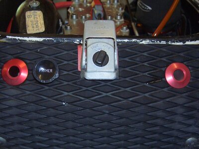

i ditched those brackets and used some carriage bolts thru the bulkhead with spacer nuts and washers...works perfect!
You ditched those brackets?!? :cool2: :sneaky:
It makes taking a waterlogged e-box out sooooo much easier...:banghead:
