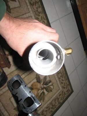

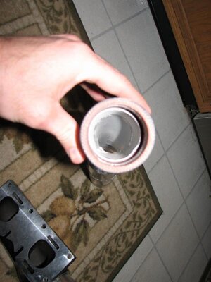

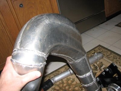

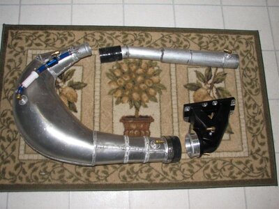

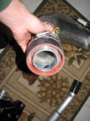

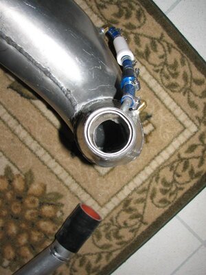

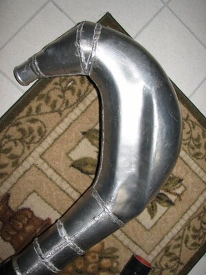

Figured I would post some pics of the EME pipe to let people know what all you get in the system. It comes with the chamber, manifold, resonator, chamber to resonator coupler, clamps, Flow control valve installed, and 4 brass mounts to strap the chamber down to the hull.
The only odd thing is that you will probably have to wrap the chamber in hydroturf and strap it down to the hull where the waterbox usually goes. It may not look as nice but I guess it will do the job.
The chamber itself looks like a type 9 laid on its side. The whole mid section is off of a type 9 that I can tell.........that may just be the outer stamping for the water jacket. Not 100% sure on that.
The resonator is simple but looks like a nice design. Small resonating chamber in the middle with a water injection fitting in the rear to help muffle the sound. The quality of everything looks nice b/c it was made by factory pipe. The welds on the inside of the pipe are very thick and clumpy in spots. I may take a sander to spots I can reach just for my own peice of mind.
Installation is very easy. However, I might have to get a jazz gas tank. the kart tank may not have enough room to fit unless you move the mounting position forward a few inches. We will see.
I am going to run this system on my standard stroke lamey PV motor. Can't wait to see how it performs. I was advised to take tuning this pipe very slow as it will make more power than a b-pipe and it will be easier to hurt the motor. For that reason I am running a stock cdi and flywheel for the time being. I just want to see how it does right out of the box first. I ahve not runthe b-pipe like that before so I will not be able to do a back to back comparison.

But honestly it looks like a monkey built it... the build quality looks terrible! and it looks like a hack job of a bunch of stuff put together.....
But I guess it only matters if it has BRAP!!!!!!!!
It does.....but the new carbon chamber from EME will look much cleaner. I personally don't like carbon chambers. Mark Baxter's company "Power Factor Products" will sell the aluminum systems. I just wated the aluminum b/c if I pay that much for something I want to make sure I can reweld something if it breaks. Not as easy to do on a carbon system.

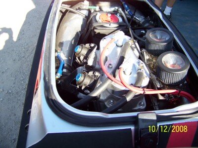

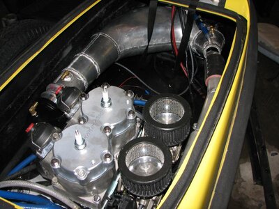

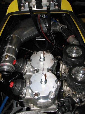

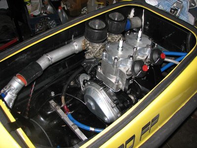

Here are more pics of how it lays in the hull. I will have to relocate the kart tank straps to the flywheel cover but it will work.

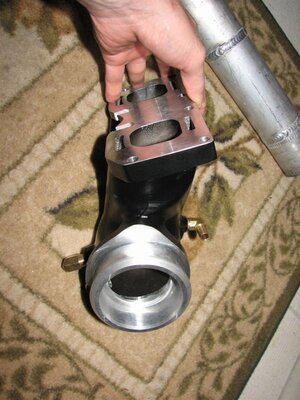

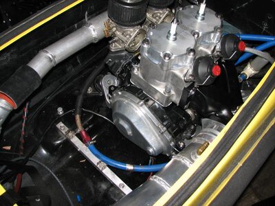

Make sure you match up the exhaust port on the manifold as their not even close to matching. Be careful not to grind too straight on the inside of the 'Y' side as I've had to weld a couple after grinding through. You have the Pre-Production model chamber not as pretty with the cut sections, both work the same.
Here's a pic of the production chambers in Mark Baxters FS-1 with the 1105cc Polaris engine.
