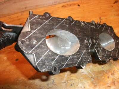

It's called filling the cross-over.
You need to make sure that it's epoxied all the way. It needs to be flush with the rest of the metal.
In the picture, it doesn't look like there is enough epoxy.

heres how mine came out. I bolted the motor together then took it all back apart to build an ss865. Never got to run it. Still have it on the shelf.

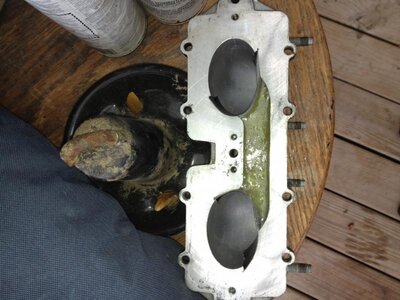

My last one was a OEM dual 44 intake that I filled the crossover tube with JB weld and ground/sanded it perfectly flush and then epoxied in bolts up through the upper carb base mounting piece and put on dual BrapJack 44's. That w/Vforce II and R&D 3° angled reed spacer worked killer!
