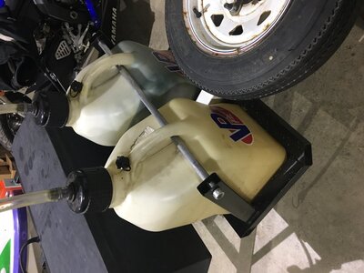

Sounds like you probably already have your design figured out, but here is how I made one for my trailer with minimum material. It holds the vp cans very solid but wouldn’t work with others because the height of the handle is what holds the can down in the bottom tray. Expanded metal sheet with rubber mat under the cans. Using 2” angle iron for the bottom tray would have made it even simpler but these are materials I had available at the time.
