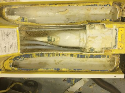

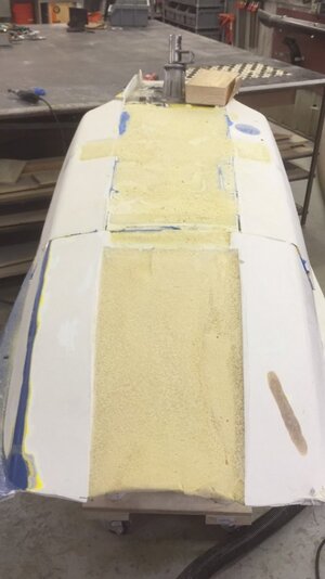

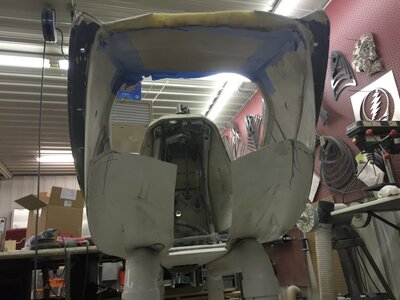

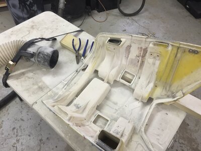

Your first post says you have everything ready for a layup. If that hull looks anything like those pictures, you have a lot of work to do before you are ready to layup.
ya I am super pumped on my motor setup I think this ski will rip! I work at my parents car stereo shop so I have made a bunch of custom fiberglass boxes (have 6 eights in my double cab tacome, yes i still have all my seats). So I have a pretty solid idea on how to glass, I just haven't used cloth before as all of our boxes are made from chop strand mat and poly resin.
the info I'm chasing after is what cloth I should be using. I know everyone uses 1208 and 1708 but is there anything better. thoughts on s-2 glass as well specifics would be awesome.
I am ready for layup on the top of the ski (hood and top of nose). I want to get that all done and reinforced first so I can look up through the gapping hole on the bottom of the hull to make sure that the hood is sealing properly. then I will proceed to other parts of the ski @vamad
