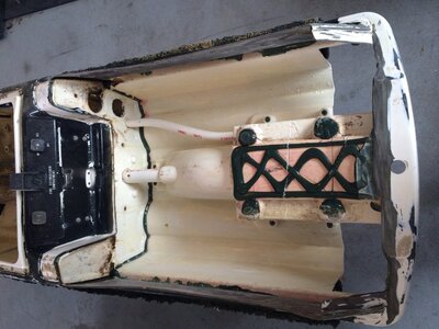

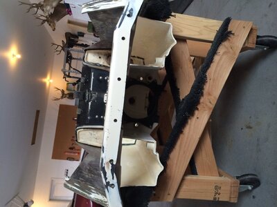

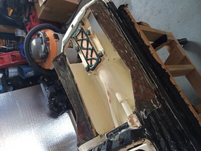

image.jpg I think I have it all sanded down as far as it can be, I am using biaxial for the most part and yes I have a fiberglass roller and squeegee. I didn't know about the rubbing alcohol but I will definitely do that and I will find something to practice on first. Thanks a lot for all the info! Here is where I'm at right now. Game plan is shortened 5inches off the back so that I can still use the second set of plate mounts, widening the tray, re shaped the tray walls and installing RRP adj footholds.image.jpgimage.jpg
