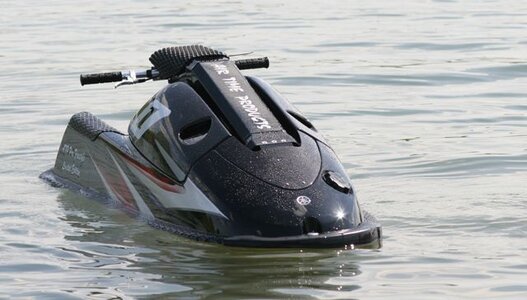

finally took the Sj out and laughed when i got in the water. i took my wetsuit and boots but didnt need them at all.. it was surprisingly warm.
Right away the ski felt a lot more unbalanced than i remember it. when its just sitting in the water the right side rail is underwater. when i lift the battery out it sits even. its a jetworx gel cell, and i knew that thing felt heavy as hell. what can i do for this? I took the fire extinguisher out and it helped some, but then im not legal.

if i had a kart tank i could probably do that. i just felt really uncomfortable out there. Ive only ridden it maybe 5-6 times, but i dont remember it being like this. I made the exhaust from the pipe ---> waterbox ---> back wall myself. and i had to move the tank back an inch or so to clear the pipe. maybe i messed up the weight distribution.

I didnt want to spend a couple hundred for the appropriate pipes (and it has a riva red pipe on it so i didnt know if the OEM would even work), so i made it out of car exhaust tubing (2" i think) to the waterbox. from the waterbox to the "firewall" i used an old 550 filler hose (connects from gas cap to tank) and a silicon connector from a FMIC to connect to what was left of the original hose. the 550 filler hose was to stiff to flex around the gas tank so i moved it back and therefore the battery tray back about an inch.

The Riva pipe is lighter and this will cause a slight imbalance. Brand new skis do this.
wow, thanks. makes me feel better about it. Im gonna try to ride as much as possible tomorrow, but if that hesitation doesnt go away, i probably wont take it to florida. If i cant do much on flatwater, riding in the ocean is going to be even worse...
i forgot about that. i did mix it pretty lean (around 48:1), that could be it. Ill mix it at about 36:1 tomorrow and see if it helps. Ill go pull the plugs right now.

Yes I'm talking about Jetting, Air/fiel mixture. Lean hesitations don't usually show up until everything gets warmed up.
