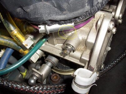

O, so go a step leaner on the main jets? wouldnt hesitation and sputtering mean too rich?
Being to rich normally gives symptoms even when you just started riding. Thats what makes me think your lean. Also sputturing can be a sign of a lean condition.
Post a good picture of the plugs and we can take it from there.
Also get me a list of what you have done and what you want for it (if you really want to sell it) I have a buddy looking for a square in Evansvlle IN.

That first picture looks pretty dry. How new are those plugs?
I would back your high speed set screw out 1/2 a turn just to see if your problem gets beter or worse. You can always put it back as long as you know where it was. Backing a set screw OUT is always the best to start with. Too rich just runs like crap too lean can cost you a motor.
Have you read the carb bible... have you done all the metering test like riding at 1/8 throtle for about a minute and hammering it to see what it does? then 1/4 then 3/8 then 1/2?
yea they are B8EVX. they look basically identical to B8ES. which is what im putting in now.
those definitely had several rides on them so its time to replace them.

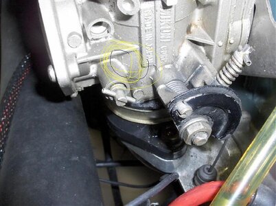

thats not a stock carb I dont think.
but yes, loostening the screw will richen it.
count and turn them into lightly seated, and tell us where they are currently set L and H screws. LIGHTLY seat them, dont crank them in with alot of pressure.

the L screws were out about 1 turn
the H screws were out about 1 1/2 turn.

I see the problem...get rid of those race Buckshot carbs! By the way, Yamaha superjet motors vibrate way too much to run spigot mounted carbs ! Must be soild mount carbs!
