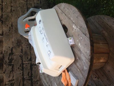

Now that I have it stripped to the bare hull I started sanding the hood luckily only one little spot I have to fix. I also removed the inner liner of the hood I'm going to lay a layer of cloth for strenght and make my own duct work. Also going to frog skin the intake hole and the holes on the front and back of the hood.
