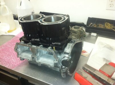

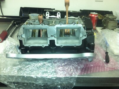

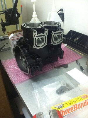

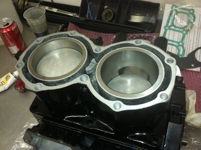

Got the motor 90% done today. Assembly went pretty smooth.
Was not fun getting the pistons in the cylinders with one set of hands, usually i have a buddy helping me.
All in all it came out good though.

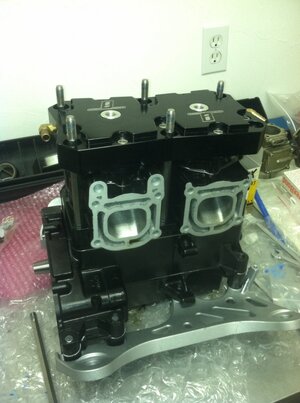

64x Cases ported amd epoxied by PHP. Trued and Welded SBT Crank. OEM Crank Seals.
61x Cylinders bored to 735cc and ported By Jet Maniac. With everything in his top end kit.

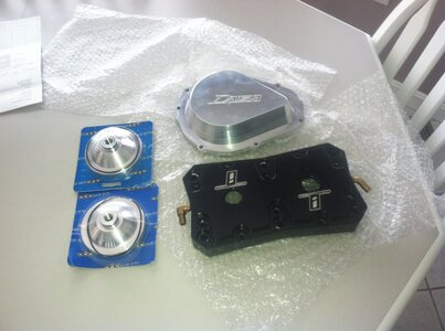

And Thrust Girdled Head with 35cc ADA domes.
(Possibly Bumping Compression after break in)
Need to fix a little problem with getting my studs all the way in but no biggie.
And waiting on stator and bendix and i can wrap up the motor.
