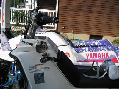

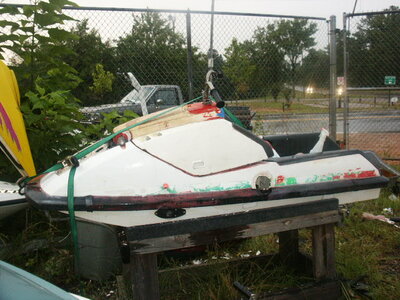

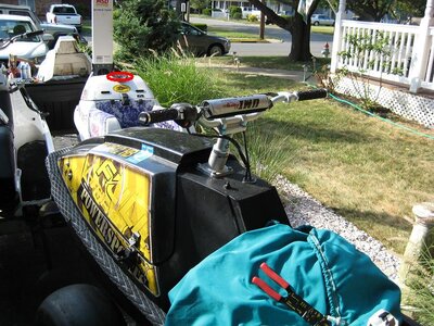

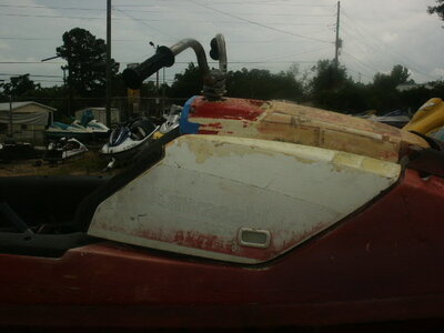

Fixing a busted coil today on my X2, and it got me thinking. What do you think of a fixed steer FX-1 conversion? I love the FX, but I dont see myself becoming a fulltime pole rider. The stock hood almost looks like its the perfect height to attach a X2 UMI system. Obviously it would need some glasswork and steering engineering, but it doesnt look impossible. Would also have to think of a way to remove the hood with a steering cable attached to it. I dont think you could do a blaster type forward pivot too easily. Just throwing it out there for some thoughts. It might be a fun winter project and a REAL fun ski, if it was done right.

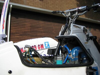

The way we did my 650SX was to attach the handlepole to the hood,the hood just swings up,it dosen't come off anymore,I just hook a tiedown strap to it and pull the hood up out of the way when i am working on it.I stopped modding the hood when Flat Brap put the 650SX race hood up for sale,I should be retrieving it in a couple of weeks and start building my new hood,Madscientist is getting this hood back,so there will be two conversion skis then.

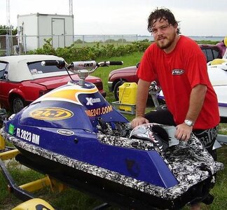

my superjet:
index.cfm
Wedo ...not passing judgement at all. it just seems strange to me but as said I havent rode one so not sure of the possibilities.
but realistically what does the fixed steer enable you to do that you cant already do on a standup? Demon enlighten me here.. and yours looks sweet as shiite BTW , never really ever seen one before

After riding my ghettoed out version for a while I don't really understand why the Superjet concept failed.I know price was one thing,that hood was ridiculously high end and was priced as such.I started looking at options and one fell right into my lap,the 650SX.They can be had for dirt cheap,they are reasonably light weight once you ditch the heavy ass handlepole,750-800 motors are a direct bolt in,750 props and be easliy modded to fit into the pumps,and the handling difference between a handlepole and fixed steering is amazing on that ski.Thanks to Flat Brap I have access to a SX race hood ,my plan is to convert that hood for freestyle usage first and pop a mold off of that,then mod it further for fixed steering and pop a mold for that as well.Carbon fiber is probably totally out for this project but a lightweight fiberglass fixed steering hood is completely doable,this would put a fixed steering ski well within reach of anyone that wants one without having to take out a second mortgage on your house.If it flops then it flops,nothing ventured ,nothing gained is what I say.

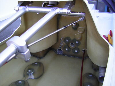

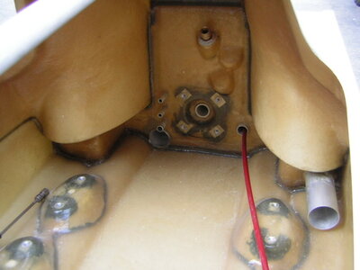

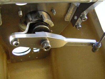

Butti or Demon,
You guys have any pics of the steering system under the hood? I never got a chance to really look over the ones Mark had laying around. Is it an off the shelf cable? On top of looking into a fixed steer FX, I need to redo the steering for my lightweight and I'm very interested what you guys are running. I am running an 89 X2 direct steer right now. While it actually works awesome, it has to be reinforced or it will break (like mine is now). And its not an easy to find part.
dbrutherford
Parts Whore
Fairmont, WV
Shawn, the japanese guys have a direct steering cable setup for X2's. They use a long cable like a stand up. Then they use the Maekawa brace. There is then a clamp they attaches to that brace that holds the steering cable in place. There is also a longer steering arm like on the Accusteer. Here is the Jet Wave ad. I also attached pictures of the Maekawa Engineering 650 X2 hull. I believe they quit making them. I remember on their website once that they said they were done making fiberglass parts.
