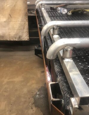

Went into the shop today and got the aluminum bunk setup mostly done. I decided to just go with two bunks. I set them out pretty far so I can put my beach cart and other stuff in the middle. The whole setup is actually pretty light and I can mount it by myself easily.

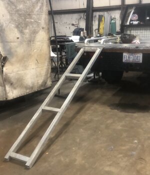

Got my ramp made today. I’m waiting on my wheels to get here for it. It’ll have 16-20 wheels for the skis to roll up. I also made the universal hooks for the rear for tie down points and for the ramp to hook into.

The wheels for my ramp came in today and they are too small. They work really good they just aren’t quite y’all enough, so I’m going to have to replace them.
