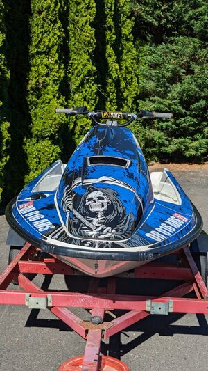

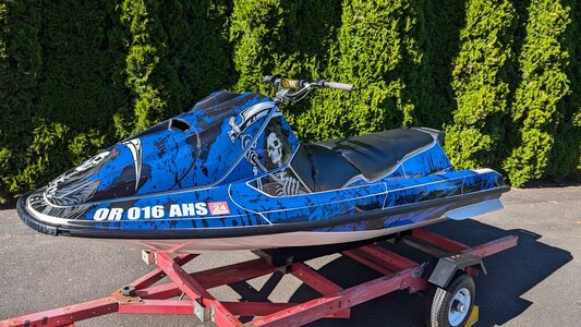

I finally got mine cleaned up and posted. It came with the decals. We called it hell raiser. Polished it and installed a new starter relay.

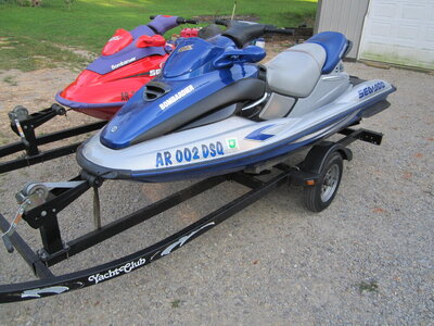

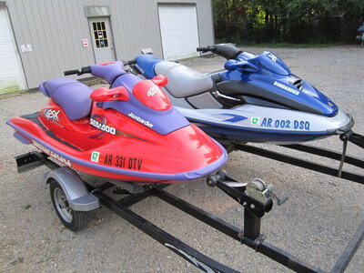

I just put the spit-shine on a couple of mine I finished up. Wife and I rode 'em for 30-45 minutes Friday evening. I put a real lashing on that Gsx lol!!
Ready to sell!.........er flip!

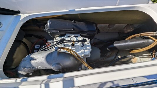

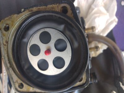

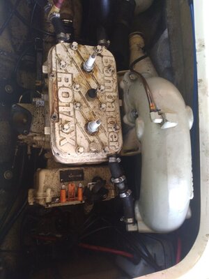

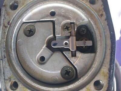

Back at it this morning , I pulled the carb to have a look see, the main diaphragm is still nice and pliable with no pinholes , good to go there , not that uncommon on Seadoos really , the carb is really clean inside which means someone must have run it out of gas when they put it up , also the fuel lines have already been replaced and are still nice and pliable so scratch that off the list as well , I haven't pulled the pump side apart but I doubt there will be any surprises there either.
I siphoned the really nasty gas out of the fuel tank , add another 30 minutes to the tab and most likely zero dollars in parts, I would say add $20.00 for fuel but I am just going to siphon the fuel back out of the 4 TEC and use it since it has Berryman B12 already in it.
I might replace the carb base gasket or maybe a pump diaphragm , the day is still young IDK..

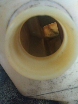

On these the filler neck goes in at the front of the tank so using a flashlight you can visually inspect most of the tank, I used a piece of fuel line and small pieces of paper towel that I twisted up to fit inside the fuel line to mop the tank out from the filler neck , towards the end I lifted the nose of the ski up and down and tilted the ski to one side on the trailer to get the last little bit out. , when the paper towels come out clean and dry the tank is done,. If you want to get really crazy you can pour in some Berryman B12 and do it all over again , not feeling crazy today.
I also pulled the carb completely apart and found nothing that didn't wipe off with WD40 and a paper towel , even the internal filter was clean. also little to nothing inside the fuel filter up front , I got really lucky on this one.
I added a pic but I doubt you can make a lot out of that pic, kind of hard to take a pic of the inside of a fuel tank. It's probably now cleaner than 80% of the fuel tanks out there in running skis and I am good with that.. Add aNOnother 30 minutes and zero dollars sprnt to the tab.

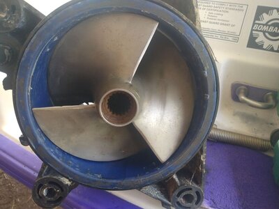

Pump- wear ring removal-replacement : 18 minutes, that includes removing the driveshaft and the old wear ring and knocking in a new wear ring , it does not include putting the pump back it, the impeller has some slight damage so it will have to be removed from the pump and repaired. We are using a cheap Ebay wear ring because they are cheap and they work way better than the stock crap .
At the 31 minute mark I have the engine unbolted, exhaust hose and stator wires loose , it is tilted over and all four engine to cradle mount bolts have been tightened, I just needed enough room to get a Snap -on 17mm flex head wrench under there , that's the second pic.
At the 41 minute mark the engine is all bolted back down with the shims in the right place and the exhaust and stator wires are hooked back up , it's now ready for an alignment check and I can put the carb and flame arrestor back on, I do have to replace the oil feed lines first though , never , I mean never skip this part on a Seadoo , it will bite you in the worst possible way if you do and that wraps up the third pic , in conclusion I will have to say yes , the old man has still got it !
Lets be generous here and add another 45 minutes on the clock and a $20.00 wear ring.

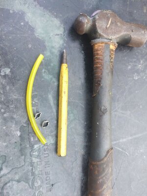

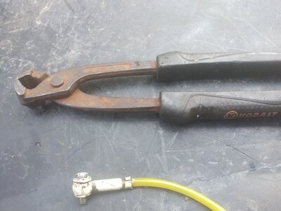

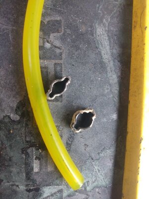

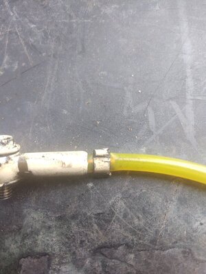

Replaced the oil lines, I use Tygon weedeater fuel line for oil lines, they are a little thicker on the wall size of the tubing , I resuse the stock clamps instead of using zip ties mostly because I have never seen an oil line come off of one with a stock style clamp on it, like I said the lines are slightly bigger , to compensate I use a center punch and a hammer to open the clamps up slightly.
Just place the clamp and centerpunch over any piece of metal that has a slightly smaller hole than the clamp and give it a tap, reverse the clamp and do it again, you can see in that first pic the difference between one that hasn't been enlarged and one that has .
When you put the clamps back on I use end nippers to retighten the clamps, you just pinch the ears on the clamps and you are done, the top hose is next to impossible to get to the clamp on so on those I remove the banjo bolt and fitting from the pump. put the hose on retighten the clamp then put it back on the pump.
The oil lines are done, the carb is back on, gas is back in the tank and the system is primed, to prime it I leave the return line loose then blow pressure into it , when you see gas coming out the return line on the carb it is primed and ready to fire up.

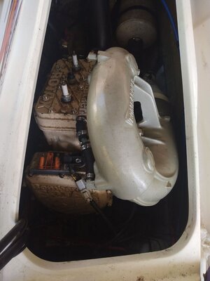

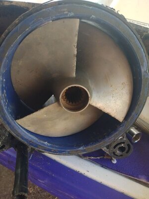

So the impeller is done, only the front edges needed attention , nothing a few passes with the angle grinder can't fix , the jet pump oil what there still was of it was nasty and chunky and about 100 hrs overdue for an oil change , I cleaned it out with Berryman B12 carb cleaner and reassembled it.
While I still had the pump out of it I installed the battery and tried to fire it off , it was having none of it, I sprayed WRU down the carb and it kicked off and ran till it ran out of W4U , I did get it to rev up and run on the main jet but it would not crank without choking or idle.
It was at that very moment that I knew exactly where I had F'ed up , I did not pull the jet plate when I had the carb off and spray carb cleaner through the jets, mainly because I didn't have any car cleaner here.
So after securing a can of Berryman B12 I partially pulled the carb back off enough to get to the jet plate and sprayed Berryman B12 ( the greatest carb cleaner on the face of the planet bar none ) through the pilot jet and watched the bypass holes, all of them were now clear , back on the carb goes and after choking it the first time it now idles and it cranks before you can get your finger off of the start button , plus no more engine dancing all over the place.
I reached down and held the oil pump wide open to fill the lines back up and it is now smoking quite nicely and it sounds really good .
I still have to refill the jet pump with oil and put it back on , really about a 15-20 minute job , so this time around clock on another 30 minutes and $ 5.00 worth of carb cleaner although I really don't usually figure shop supplies into the equation.

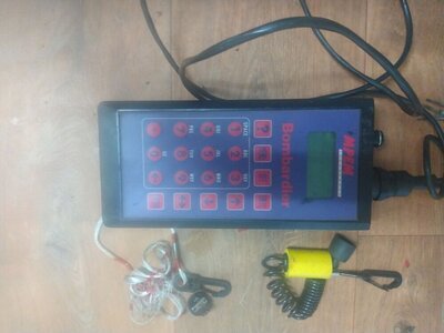

The DESS key on this was past being shot , it actually crumbled when I put it on the post and fell off what was left of the cord , amazingly it still worked as long as you held it on the post.
I was digging around looking for parts at the lake and I came across a ski with a dead engine that I had bought for parts , it had what appeared to be a brand new DESS key in the glovebox , so I snagged it and programmed it up to this ski , since this is an older ski it will program up with the handheld programmer , which makes this about a two minute process.
I programmed it up and vroom vroom
Time spent , maybe 5 minutes mostly because the programmer was searching for the last ski I hooked it up to and kicking off error codes and it took me a minute to get that cleared out of the programmers memory , total of zero dollars spent.

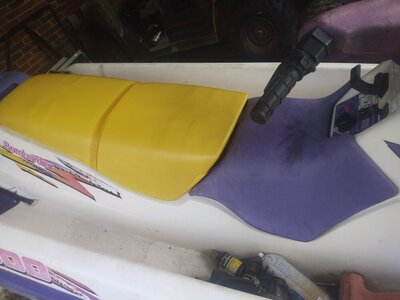

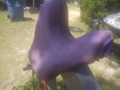

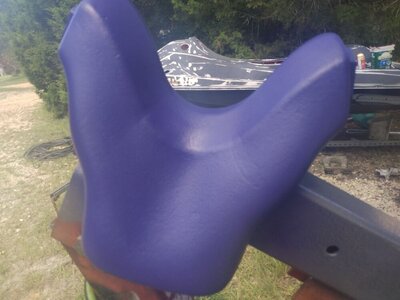

I retrieved the seat from the shop , it was quite dirty from sitting on the shelf but some LA Awesome cleaner perked it right up , that is a brand new NOS seat that was still in the plastic and it has been waiting for a machine to go on for some years now , there is still some mildew or something on the strap so I am removing just the strap and soaking it in ODOBAN , hopefully it will kill the mildew spots if not I can probably just flip it over or worst case cover it with vinyl and sew it.
That is probably the colors palate I am going with Purple fore seat , Yellow seat , but it saves me probably an hour to an hour and a half of recovering the original seat .
Time spent maybe 10 minutes , money spent $6.00 worth of LA Awesome cleaner and a new spray bottle .

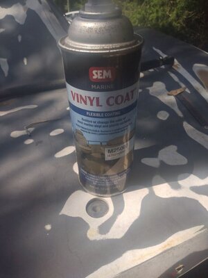

Today we are repairing the handlebar cover , this one is still fairly nice and hasn't yet reached the playdough stage so I am just respraying it purple using SEM vinyl dye.
You don't have to follow my instruction at all , this is how I do it, you can follow SEM's instructions and buy everything they tell you to buy and it will turn out beautiful, you will also be very , very broke.
They want you to use SEM soap , then SEM plastic or leather prep , then SEM adhesion promoter then SEM vinyl coat , yeah we are not doing that.
I started by spraying with LA Awesome cleaner and using a dish scrubber scrubbed the surface, then I use Clorox foaming cleaner to see if I could kill the mildew, once that is dry I use a rag and acetone, this opens the pores in the surface slightly.
Then I spray a couple of coats of Rustoleum adhesion promoter , you can use Bulldog if you want , this is much , much cheaper, then I spray a coat of SEM vinyl dye then wait about ten minutes and follow up with a second coat. The results speak for themselves SEM purple is pretty much an exact match to Seadoo or Yamaha purple . One can of this goes a long, long way, I have redone several skis with this one can of Marine coat vinyl dye.
