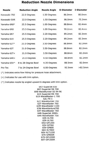

Some shops are using a flexible plastic, metal, and/or rubber extension on the fixed nozzle to seal the gap at full throw.
Some OEM Yamaha trim rings have rubber extensions on them that are longer on the sides to prevent water from getting out.
The flow guard is not about the trim.
Before I do a search (I'm lazy) Do you know what model? Are they a bolt on swap with a SJ?
