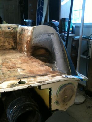

My last holds were very comfy and kicked in solid. 1" on top and bottom. And used 1/4" on the sides, then turf. Not much of a gap where the toes were, so i kicked in hard, but once kicked in it was very solid. I will say though it really helped my riding. Felt more confident, which got me to try more stuff. Just felt good being locked in. And still was able to get out easily when I needed to bail.
