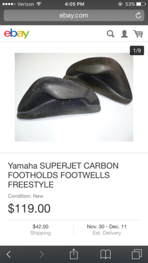

Thanks, ill have to look into those. Also, I have no experience with installing them but from what I've heard it really isn't that hard. What do you think?Those footholds look tiny and not comfy. I ran @tom21 footholds in my square and loved them. 26mm pad top and bottom. @TOBY makes some nice budget priced ones too. But, @CrazyJoesRacing came out with a set of holds that look super nice too.
Thank you!Not that hard at all. Just takes time, having the right tools, some patience and some creativity.
Id stay away from the blowsion kickers. I installed them in a SN one time, and they were very thin and didnt fit very well. When I put some expanding foam behind them, the foam actually pushed the bottom of the footholds up and I had the grind down the bottom of the holds and glass the bottom flat...pain in the butt.
Definitely look into the holds @Roseand posted about....solid footholds with lots of room for padding. Comfy holds = Happy Feet and Ankles.
