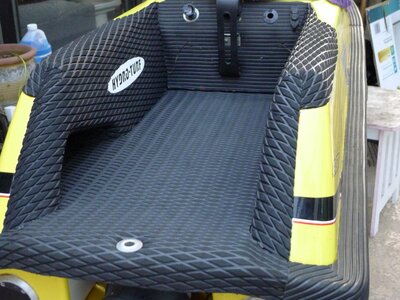

All around footholds. Shape your foam, glass over and turf. Adds 3 inches to your tray on each side too. Only cost me materials and my time. 10000x better than any normal footholds that stick out in the tray. Wider stance is also way better around the buoy course too
I have also had normal footholds in many different squares and roundnoses and absolutely hated them. If you don’t want to chop up your new SJ, @tomski makes a sweet bolt in front foothold. I have one in the pictures I posted.
